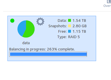

Balance in progress (over 100%)
Is this normal? :smileysurprised: I'm starting to worry something may be up.

Just an update on this:
Having now replaced all 4 drives in the array with new ones, the last re-balance i did only took a couple of hours, and did not go over 100%.
admittedly it only had to balance about 5 blocks, which took a while but at least it didn't drift off in to another dimension this time.
Currently doing a scrub which is also taking its time, but with any luck the issue seems to be resolved now.

Yes i have a backup, I'd actually recently moved all the data across from an old NV+ though i am in the process of replacing the drives. Once all the drives are replaced with new ones i'll re-run the balance to see if it does it again. If so im preparing myself to do a factory reset.

Great news, thx for sharing it.
Scrubs will take a while, since all the files are checked.
