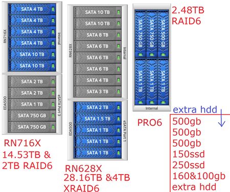

Best way to build 2 NAS Server (25TB each RAID6) for replication - using existing readynas hardware
we are trying to build 2 NAS servers with around 25TB RAID6 Storage (replicate with each other -21TB used so far) & we need to figure out the least expensive way to do this utilizing existing hardwar...

I'm not sure if your target sizes are TiB or TB. I'm assuming TiB.
The general rule with dual redundancy is that the four largest disks should all be the same size. Otherwise you are wasting space. IMO the small disks don't really help enough to be worth the trouble.
What I would do is get one more 6 TB drive and go with
RN716x: 4x10TB+8 TB -> 28 TB (25.4 TiB) of total storage
RN628x: 4x6TB+4x4TB-> 28 TB (25.4 TiB) of total storage
No need for the EDA500s or small disks.
If you can't spend anything on new drives then go with
RN628x: 3x6TB+5x4TB (24TB) with a second volume on one of the EDA500s: 1x3TB + 3x2TB (4 TB).
That also gives you 28 TB total, though split across two volumes. Note it wastes space on both the 628x and the EDA500 (since the four largest disks aren't the same size).
The drawback with both plans is that they require a full backup of your existing setup before you can migrate to it. I don't see any path that avoids that problem though.

- kevinfor2014May 09, 2017Guide
thanks Stephen,
we don't have extra space to backup both NAS for drive changes at the same time.. - so I think we will move a single 10TB over to the 716 convert to XRAID5 rsynce all the data onto it, factory reset 628x with the drives mentioned above.. resync to it.. then factory reset the 716x with RAID6.. then nightly rsync so one is a mirror of the other.
what is your thoughts on 10TB drives between WD Gold & Ironwolf/standard & pro ... Lastly XRAID6 -vs- FlexRaid6 - if a 6 bay NAS factory reset with XRAID5, and you install (500,640,750, 1,1.5TB,2,2.5TB) Click to turn off XRAID - Set FlexRAID6, let it finish it's rebuild.. then click XRAID on - does that give you 3.5Tib usable, 1.82Tib protection & 2.73Tib unused( like XRAID6 should) - or only 2.25Tib usable 931Gib protection & 4.9Tib unused (like FlexRaid6 per the xraid calulator) with the 4.x code you could setup "factory reset with dual redundancy" Xraid6 out of the box with 6 drives.. that only seems to be an option now with 8 bay or above..
That should work too, assuming that you are also putting 4x10TB on the RN716 before the final reset. 2x4TB and 1x8TB will both work, I suggested 1x8TB to give you an empty slot for expansion (plus you waste 2 TB if you deploy a single 8 TB in the RN628).
