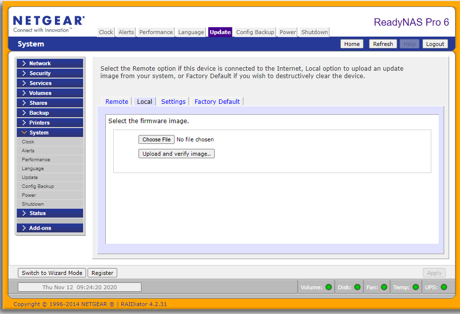

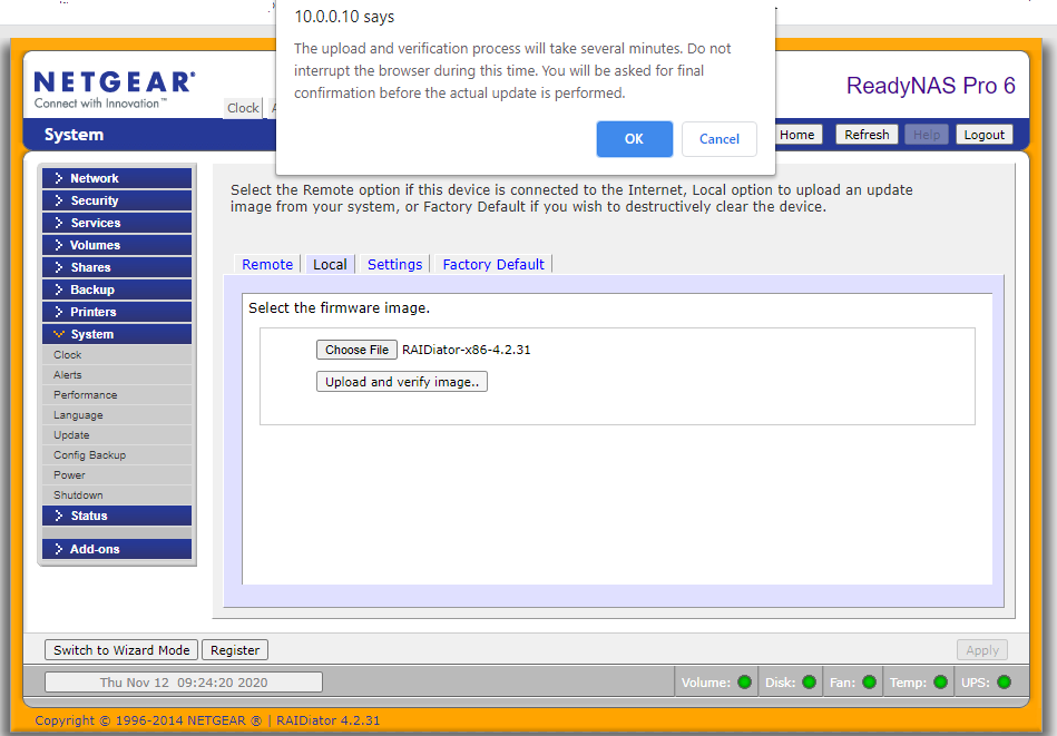

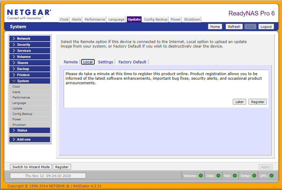

You should be doing this:
You do need to click past the register screen (using "Later"). Then choose the binary (extracted from the zip), and then "upload and verify image". After that completes, there should be another pop-up to confirm the install.
Disable the pop-up blocker in your browser for the NAS admin ui.

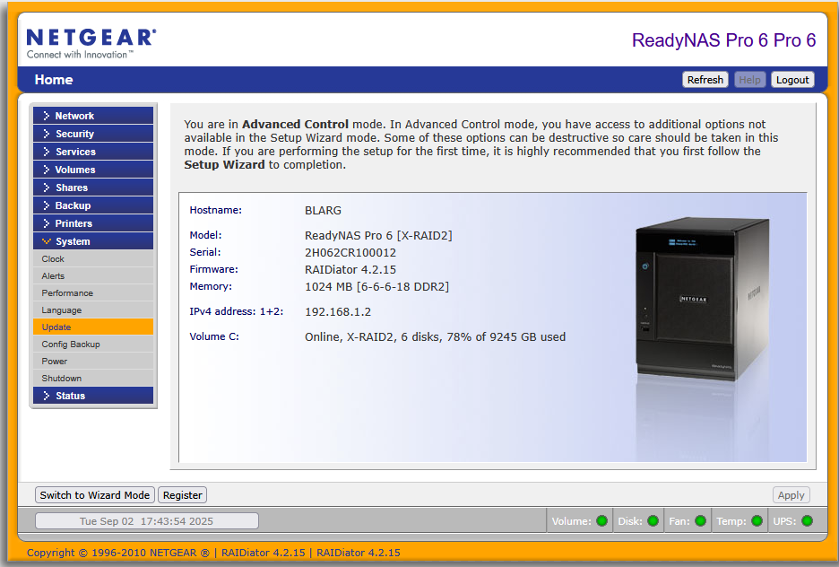

Here are screen shots of what I've got.
Here is the screen with the System rolldown opened. Notice there are no tabs on top like in yours:
So I click on Update in that rolldown and all that happens is it rolls back up. I've tried this numerous times.
FWIW, I never ran 4.2.15 firmware. My own Pro 6 was purchased shortly after 4.2.17 was released.
You could click on register, and then see if you can skip over the registration process. That might get you to a point where you can upload the binary.
It is also possible that your very old firmware isn't behaving well with current browsers. So you could maybe try saudade's suggestion to use an older FF.
