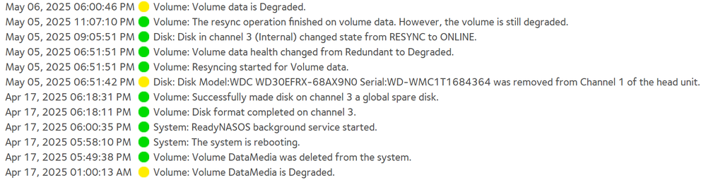

I have a reasonably old RN314 which I have had to fix up some failing drives.
Having resynced the volume from one disk to a new hot spare, the volume says it's still degraded. I have tried to post this with evidence, but the posts keep disappearing
I ran a disk test which said both drives had failed, but both are working seemingly fine. One of the log files has
May 29 11:33:39 Surire readynasd[3045]: Failed to call method ResetFailedUnit noflushd.service: No such file or directory
May 29 11:33:40 Surire readynasd[3045]: Disk test started for volume data.
May 29 11:36:24 Surire readynasd[3045]: Disk test failed on disk in channel 2,  model WDC_WD30EFRX-68AX9N0, serial WD-WMC1T2306984.
May 29 11:36:24 Surire readynasd[3045]: Disk test failed on disk in channel 3,  model WDC_WD30EFRX-68EUZN0, serial WD-WCC4N6XZY5N8.
Do you think this is now something I should treat as dead - it's quite many years old - bought in 2011.
Not really sure I want/need to replace it...
