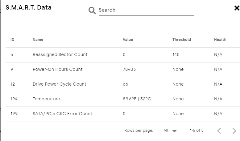

- mrputtputtJul 12, 2024Tutor
just back to town... it took 2.5 hours to low level format using diskpart and clean all for the 1tb drive.maybe the mini-tool partition is like my acronis trueimage using some dod algorithm to erase the drive? clean command didn't take as long as mini-partition tool.
i couldn't wait longer the other night so unsure if the one i did earlier is consistent in speed. not sure what SMART info is valuable using WDD's digital dashboard. it says health is normal, gen 3 6.0 gb/s and some write performance numbers since i'm doing a second pass at low level format to see if the duration of the process is same as the other 1tb drive. i stopped the clean command to run a short diagnostic and info is attached.i'll had to do the same for the other drive.

- StephenBJul 15, 2024Guru - Experienced User
mrputtputt wrote:
not sure how else to eliminate the 12v power supply.
The easiest way is to do a risk-buy of a replacement.
