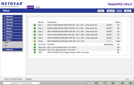

Disk shows Dead. Volume shows fine.
I have X-Raid with dual redundancy configured. A disk failed on me and I went to pull out the bad drive. Stupid me for not checking, but I pulled out disk 6 when disk 4 was the dead drive. I was n...

I have poked around, but don't know exactly what I am looking at. Here are a couple things. Any suggestions as to what to look for?
enclosure.log
temp!!1!!status=ok::descr=50.0C/122.0F::expected=0-65C/32-149F temp!!2!!status=ok::descr=30.0C/86.0F::expected=0-60C/32-140F fan!!2!!status=ok::descr=924RPM::type=SYS1 ups!!1!!status=ok::descr=CPS CP1350PFCLCD Battery charge: 100%, 21 min volume!!1!!status=ok::descr=Volume C: RAID Level X2, Redundant; 9250 GB (83%) of 11110 GB used disk!!1!!status=ok::descr=Channel 1: Hitachi HDS5C3030ALA630 2794 GB, 35C/95F disk!!2!!status=ok::descr=Channel 2: Hitachi HDS5C3030ALA630 2794 GB, 38C/100F disk!!3!!status=ok::descr=Channel 3: WDC WD30EFRX-68AX9N0 2794 GB, 33C/91F disk!!4!!status=ok::descr=Channel 4: Hitachi HUA723030ALA640 2794 GB, 38C/100F disk!!5!!status=ok::descr=Channel 5: WDC WD30EFRX-68EUZN0 2794 GB, 34C/93F disk!!6!!status=ok::descr=Channel 6: WDC WD30EFRX-68EUZN0 2794 GB, 31C/87F model!!0!!mode=home::descr=ReadyNAS Ultra 6::arch=x86
a snipet of system.log
Mar 10 22:23:04 tesla6 RAIDiator: New disk detected. [Disk 6] (tesla6) : A new disk was added to the ReadyNAS. If multiple disks have been added, they will be processed one at a time. Please do not remove any added disk(s) during this time. Mar 10 22:25:12 tesla6 kernel: sdf: unknown partition table Mar 10 22:25:15 tesla6 kernel: sdf: sdf1 sdf2 sdf5 sdf6 Mar 10 22:25:16 tesla6 kernel: md: bind<sdf1> Mar 10 22:25:16 tesla6 kernel: RAID1 conf printout: Mar 10 22:25:16 tesla6 kernel: --- wd:5 rd:6 Mar 10 22:25:16 tesla6 kernel: disk 0, wo:0, o:1, dev:sda1 Mar 10 22:25:16 tesla6 kernel: disk 1, wo:0, o:1, dev:sdb1 Mar 10 22:25:16 tesla6 kernel: disk 2, wo:0, o:1, dev:sdc1 Mar 10 22:25:16 tesla6 kernel: disk 3, wo:1, o:1, dev:sdf1 Mar 10 22:25:16 tesla6 kernel: disk 4, wo:0, o:1, dev:sde1 Mar 10 22:25:16 tesla6 kernel: disk 5, wo:0, o:1, dev:sdd1 Mar 10 22:25:16 tesla6 kernel: md: recovery of RAID array md0 Mar 10 22:25:16 tesla6 kernel: md: minimum _guaranteed_ speed: 100000 KB/sec/disk. Mar 10 22:25:16 tesla6 kernel: md: using maximum available idle IO bandwidth (but not more than 200000 KB/sec) for recovery. Mar 10 22:25:16 tesla6 kernel: md: using 128k window, over a total of 4194292 blocks. Mar 10 22:25:54 tesla6 kernel: md: bind<sdf5> Mar 10 22:25:54 tesla6 kernel: RAID conf printout: Mar 10 22:25:54 tesla6 kernel: --- level:6 rd:6 wd:5 Mar 10 22:25:54 tesla6 kernel: disk 0, o:1, dev:sda5 Mar 10 22:25:54 tesla6 kernel: disk 1, o:1, dev:sdb5 Mar 10 22:25:54 tesla6 kernel: disk 2, o:1, dev:sdc5 Mar 10 22:25:54 tesla6 kernel: disk 3, o:1, dev:sdd5 Mar 10 22:25:54 tesla6 kernel: disk 4, o:1, dev:sde5 Mar 10 22:25:54 tesla6 kernel: disk 5, o:1, dev:sdf5 Mar 10 22:25:54 tesla6 kernel: md: delaying recovery of md2 until md0 has finished (they share one or more physical units) Mar 10 22:25:58 tesla6 kernel: md: bind<sdf6> Mar 10 22:25:58 tesla6 kernel: RAID conf printout: Mar 10 22:25:58 tesla6 kernel: --- level:6 rd:6 wd:5 Mar 10 22:25:58 tesla6 kernel: disk 0, o:1, dev:sdc6 Mar 10 22:25:58 tesla6 kernel: disk 1, o:1, dev:sdf6 Mar 10 22:25:58 tesla6 kernel: disk 2, o:1, dev:sda6 Mar 10 22:25:58 tesla6 kernel: disk 3, o:1, dev:sdb6 Mar 10 22:25:58 tesla6 kernel: disk 4, o:1, dev:sdd6 Mar 10 22:25:58 tesla6 kernel: disk 5, o:1, dev:sde6 Mar 10 22:25:58 tesla6 kernel: md: delaying recovery of md3 until md2 has finished (they share one or more physical units) Mar 10 22:26:00 tesla6 kernel: md: md0: recovery done. Mar 10 22:26:00 tesla6 kernel: md: delaying recovery of md3 until md2 has finished (they share one or more physical units) Mar 10 22:26:00 tesla6 kernel: md: delaying recovery of md2 until md3 has finished (they share one or more physical units) Mar 10 22:26:00 tesla6 kernel: md: recovery of RAID array md3 Mar 10 22:26:00 tesla6 kernel: md: minimum _guaranteed_ speed: 1000 KB/sec/disk. Mar 10 22:26:00 tesla6 kernel: md: using maximum available idle IO bandwidth (but not more than 200000 KB/sec) for recovery. Mar 10 22:26:00 tesla6 kernel: md: using 128k window, over a total of 976751296 blocks. Mar 10 22:26:01 tesla6 kernel: RAID1 conf printout: Mar 10 22:26:01 tesla6 kernel: --- wd:6 rd:6 Mar 10 22:26:01 tesla6 kernel: disk 0, wo:0, o:1, dev:sda1 Mar 10 22:26:01 tesla6 kernel: disk 1, wo:0, o:1, dev:sdb1 Mar 10 22:26:01 tesla6 kernel: disk 2, wo:0, o:1, dev:sdc1 Mar 10 22:26:01 tesla6 kernel: disk 3, wo:0, o:1, dev:sdf1 Mar 10 22:26:01 tesla6 kernel: disk 4, wo:0, o:1, dev:sde1 Mar 10 22:26:01 tesla6 kernel: disk 5, wo:0, o:1, dev:sdd1 Mar 10 22:53:14 tesla6 RAIDiator: RAID sync started on volume C. Mar 10 22:53:15 tesla6 RAIDiator: RAID event detected. (tesla6) : RAID sync started on volume C.\n\n[Sat Mar 10 22:53:14 EST 2018] Mar 10 23:41:30 tesla6 chronyd[3309]: Selected source 192.168.1.1 Mar 11 00:00:02 tesla6 RAIDiator: The on-line filesystem consistency check has started for Volume C. Mar 11 00:00:03 tesla6 RAIDiator: Volume consistency check started for Volume C. (tesla6) : The on-line filesystem consistency check has started for Volume C. Mar 11 00:00:05 tesla6 kernel: EXT4-fs (dm-3): INFO: recovery required on readonly filesystem Mar 11 00:00:05 tesla6 kernel: EXT4-fs (dm-3): write access will be enabled during recovery Mar 11 00:00:12 tesla6 kernel: EXT4-fs (dm-3): recovery complete Mar 11 00:00:12 tesla6 kernel: EXT4-fs (dm-3): mounted filesystem with ordered data mode. Opts: acl,user_xattr Mar 11 00:12:26 tesla6 RAIDiator: The on-line filesystem consistency check completed without errors for Volume C. Mar 11 00:12:27 tesla6 RAIDiator: Volume consistency check completed for Volume C. (tesla6) : The on-line filesystem consistency check completed without errors for Volume C.
