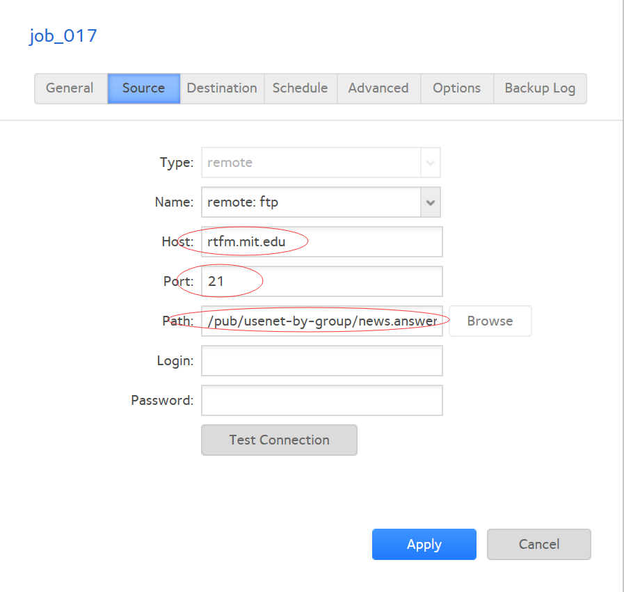

I tried it in 6.9.3, using the MIT FTP Web site(which can be accessed anonymously).
ftp://rtfm.mit.edu , "Host" area - input FTP web site directly, "Port" area - by default(display 21), "Path" area - input specify the path to copy files.Run backup job, completed.BTW: In system -> setting, FTP - anonymous modeBackup Job Name: job_017
Backup Job Type: Full
Protocol: ftp
Backup Source: [remote:ftp]/ftp://rtfm.mit.edu//pub/usenet-by-group/news.answers/3b1-faq
Backup Destination: [ss1]/1!22
Backup Start Time: Mon Apr 2 2018 22:40:31
Backup Finish Time: Mon Apr 2 2018 22:40:47
Backup Status: Success
Copy (F) part1
Copy (F) part2- Netrage2Aspirant

If I set the "source " as "/pub/usenet-by-group/news.answers/3b1-faq", run backup job, there are some files being download to NAS.
I set the "source " as "/pub/usenet-by-group/news.answers/", run backup job, there are no files being download to NAS. I'm not sure if it's a server problem.
However, you said that want to copy all the files under the root directory, do not want to enter the specified path. This problem I have submitted enhancement bug, if fixed, please try it in the next version.
