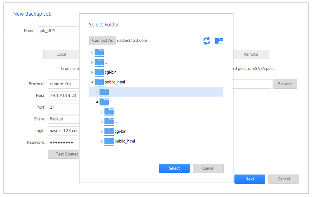

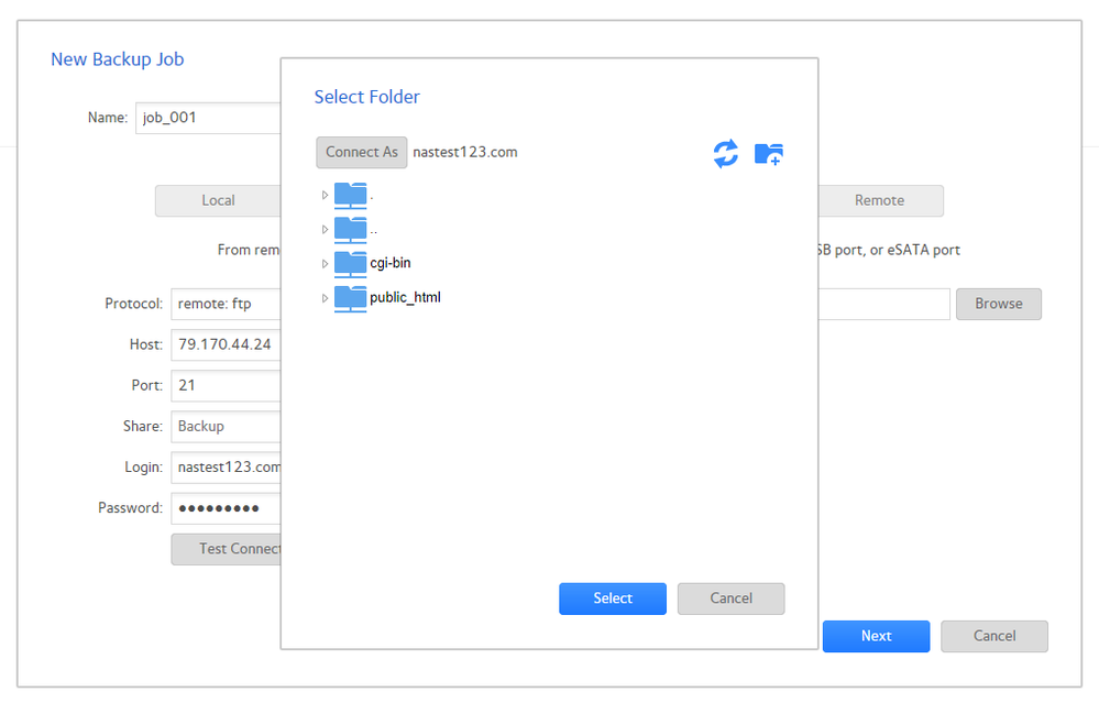

Firstly when setting up a backup from FTP to NAS the option to 'browse' by the side of the 'share' field brings up the following window.
Selecting the . or .. does enable me to backup from 1 level above the root folder (in my case public_html)
However the structure fails to display correctly when opening further folders and subfolders from this windows as shown below
The actual structure is
cgi-bin
public_html/test
but I can keep opening folders from within this window and end up with a never ending cascade.
Another isssue here is that once the backup job is created, if you want to then go back into that job and browse from the 'share' field again (to change what is being backed up for example) the 'browse' button does not function. The only solution is to manually type the path or delete the backup job and start again.
