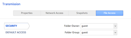

Can you provide a screenshot of the network access settings for a share that still is accessible with SMB as guest?
Is the share owned by guest?

None of the shares are mountable by user guest. As per the 2nd screenshot above - when trying to mount they all give this error.
What I'm surprised about is that although "anonymous" is unchecked in Network Access for all the shares in the 1st screenshot I can still see a list shares when connecting via SMB as guest.
Compare this to connecting using AFP - when I can't get any list of shares. Selecting "Guest" in the login dialog for AFP and clicking OK gets a "connection failed" message. With SMB selecting "Guest" in the login dialog gets a "successsful login" and displays the list of shares in the 1st screenshot - even though you can't then mount any of the shares.
As requested here's a screen shot of the network access settings for one of those shares "USB_HDD_5":
Thoughts on this difference between SMB and AFP?
