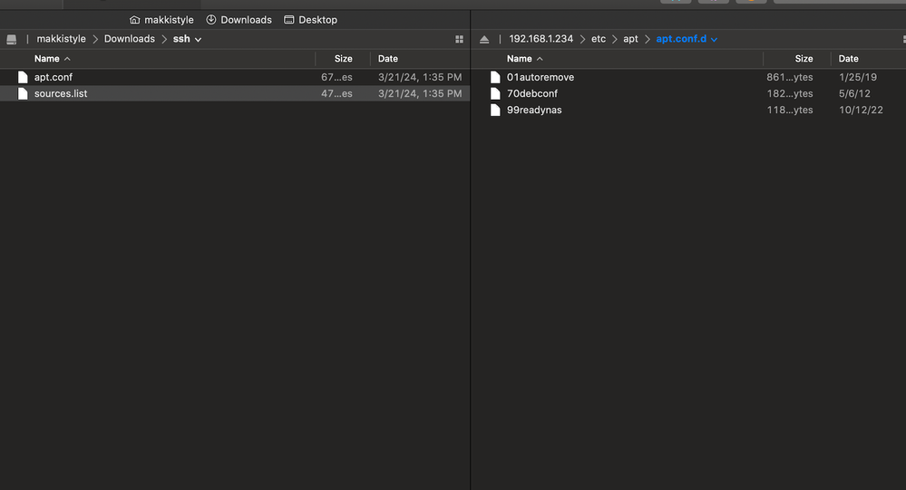

I manage to access :
can you just guide me for last step
I just have to replace the file I downloaded ( sources.list ) over NAS version ?
what about the file ( apt.conf ) where it should go ?
makkistyle
Mar 21, 2024Tutor
there is a file ( apt.conf.d )
and this what shows inside :
- StephenBMar 21, 2024Guru - Experienced User
I replied to your other post
- SandsharkMar 22, 2024Sensei - Experienced User
So apt.conf.d is a directory, not a file. I don't run OS6.10.10, though maybe I do need to put it on a virtual machine to investigate. Is this the new home of sources.list, or is there still one at the level above? What are the contents of that apt.conf?
I'm thinking that Netgear may have created apt.conf.d as a safe place to put mods to sources.list and apt.conf that don't get over-written by an OS update.
Indeed, sources.list.d seems to be a place where apps can put their own sources.list and not worry that an OS update will change them. On my VM with Docker installed, it's sources list is there, called docker-cli-rnapp.list. Don't do anything with them. You need to put apt.conf and the updated sources.list in /etc/apt.
