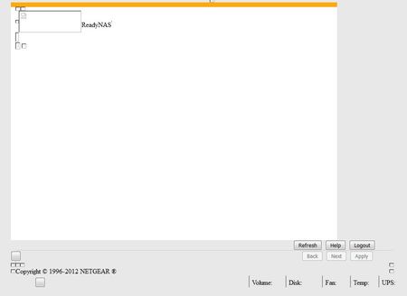

Hi,
Readynas NV+ / 4x2To / X raid
FW 4.1.15
W7 + Firefox 51.0.1 32 bits
Yesterday I had problems to access my files, both with SMB and NFS.
I saw with Frontview that both protocol...
- Mar 01, 2017
The main system log and the ReadyDLNA log filled the 2GB root volume.
