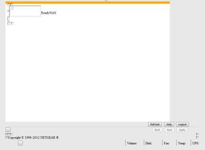

Hi,
Readynas NV+ / 4x2To / X raid
FW 4.1.15
W7 + Firefox 51.0.1 32 bits
Yesterday I had problems to access my files, both with SMB and NFS.
I saw with Frontview that both protocol...
- Mar 01, 2017
The main system log and the ReadyDLNA log filled the 2GB root volume.
- JPM39aMar 01, 2017Aspirant
Thanks to stephen for his diagnosis and to mdmd for his intervention, my problem has been solved very fast and without any data loose.
One last question: since 2 or 3 weeks it was impossible to shut down the nas with frontview. I had to press the power button. I did not take care of this matter but I'm now wondering if it wasn't the first symptoms of the full OS partition.What is your opinion about that ?
Thank you again and have a good day.
