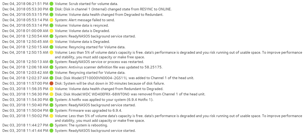

I have a RN316 with 6 x 4TB HDDs ina a RAID 5 configuration.
There is less than 5% free space left.
So I want to replace all of them with 10TB HDDs so that the RN316 automatically resizes the RAID 5  volume from 24TB to 50TB.
  1. So first I upgraded the firmware to 6.9.4 (Hotfix 1).
  2. Then I powered up the RN316 and while it was running I took at the first 4TB HDD.
  3. The web app obviously said the RAID set was degraded
  4. I did notice that it did pop up a message in the web app that it would be shut down, but I ignored it.
  5. I inserted the new virgin 10TB HDD.
  6. It initialised it and then started to sync/rebuild the RAID set.
  7. An hour or so later I noticed that the RN316 had automatically shut down.
  8. At first I though it was because of my "power down policy", but I was wrong.
  9. It seems that the shutdown message in step 4 took precedence over the insertion of rebuilding the RAID set.
  10. So I powered up the RN316.
  11. It rebuild the RAID set in 18 hours or so
  12. Everything is fine.
But...
Is this a bug that the RN316 automatically shuts down instead of continuing the rebuild of the RAID set? (Even though it did not have a hot spare.)
Surely in cannot be "by design"?
Anyway, thought I might post this here...
Log below:
    Please look on system->settings->alerts in the admin web ui, and let us know if the checkbox next to "Shut down the system when a disk fails or no longer responds" is checked.
    It does sound like there is a bug (the disk insertion/RAID rebuild should have canceled the shutdown),  I suggest clearing that particular setting - at least while you are doing the upgrades.

      You are correct, the "Shut down the system when a disk fails or no longer responds" is checked.
      Although, similar to your reply, it seems to me like a bug as it should cancel the shutdown if a replacement HDD is inserted within the 30 minute grace period.

        Surely the alert is for the use case when you are not present and cannot replace the HDD relatively quickly, in which case you would argue that you shut down the NAS as another HDD could fail mathematically (so higher risk, than shutting them down and hoping they come up and are OK.)
        Likely that is the use case.  Of course a disk failure can look like a removal, so I understand why the timer would start then.  However, the insertion should cancel it.
