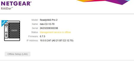

Management SErvice is offline 6.7.5
I have a ReadyNAS Pro 2 with 6.7.5 I had lost a hard drive and decided to do a factory reset to remove the RAID array. After I did that, I have had this issue. I have taken out the hard drive and ...

Sorry I forgot to tell you that the fwbroker is not responding either.
I have tried the USB with 6.8.0 RC3 but I don't seem to be getting it to apply.
I am going to try with another USB drive. I just notice that 6.8.0 just came out. So I downloaded that last night but did not have a change to try it yet.
Thanks again for the suggestion. This is the first time it has been this difficult. I have been using 6.X since it came out on this readynas and have had no real issues.
