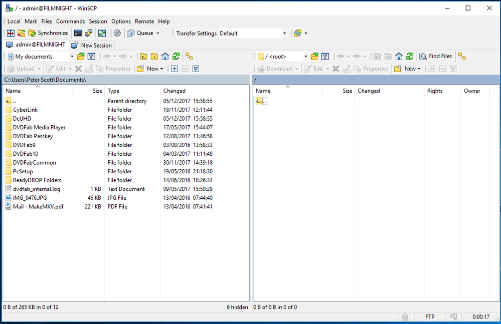

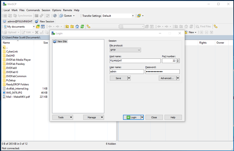

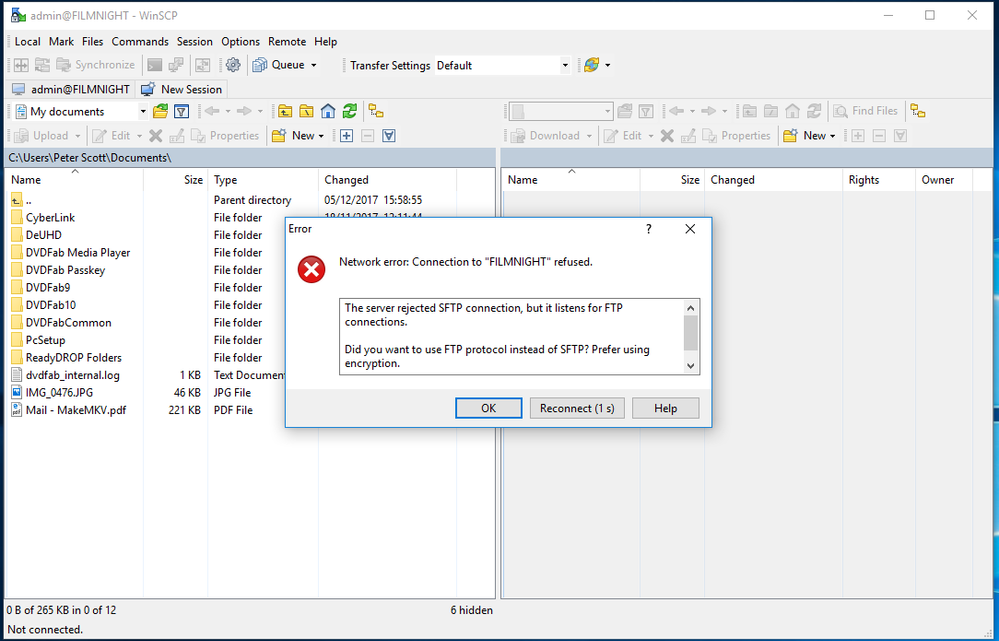

Hi guys tried your instruction i've got stuck
Looked in frontview to enable SSH got warning that if enabled Netgear would deny help and as didn't know if could disable after got nervous
So downloaded WinSCP tried all sorts of things using FTP typed some of your commands plus the one from the plex website /apps/plexmediaserver/MediaLibrary/Plex media Server
all to no avail
New drives arrived today but would rather wait to see if i/we can managed to save and restore the Plex inc file any help suggestions would be most appreciated as always from you guys
- StephenBDec 09, 2017Guru - Experienced User
pgjscottieuk wrote:...Looked in frontview to enable SSH got warning that if enabled Netgear would deny help and as didn't know if could disable after got nervous...
I told you how to do it without ssh here: https://community.netgear.com/t5/Using-your-ReadyNAS/Migrate-a-volume-os6-readynas-316-to-516/m-p/1450029/highlight/true#M139629
The commands in my post are all done from Windows, no ssh involved.
