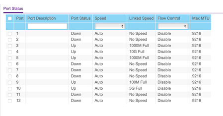

MTU settings XS512EM switch
Hi under port status it says my maximum MTU is 9216 on all ports my RAX120 is set at 1492 my readynas 626x is set at 9000 i have set my mac to 1492 i guess this would create a bottleneck at the switc...

Why on the switch? Assuming your NAS and the Mac are on the wired network, the bottleneck eg. when it comes to NAS access using SMB 3.x protocol - is the low MTU on your Mac, and probably devices connected to your RAX120. SMB 3.x can take advantage of Jumbo Frames for example.
When it comes to the RAX120 - I'm not convinced the MTU configureable does apply to the internal switch ports - much more likely it's a limit set on the Internet/WAN adapter.
Said this: What is the point to limit the Mac wired adapter to the low (even if it's the "standard") MTU? Your router can deal with the jumbo frames, the router would notify if there is an initial attempt to send a JF through the router to the Internet by the PMTUD process.
Because the XS512EM is a L2 switch (read no routing) there is nothing the switch could do if one would lower the MTU - because the traffic does not go over a router connection, there would not be any PMTUD action happen at the switch, just between the connected devices.

You can keep (wherever the adapters and drivers supporting) a high or even maximum Jumbo Frame, typically 9014 on all the wired adapters.
Wireless does not support any Jumbo Frame, so nothing to change from the defaults there, too.
The switch is "just" able to handle frames on "any" size. Thus nothing to change there either.
