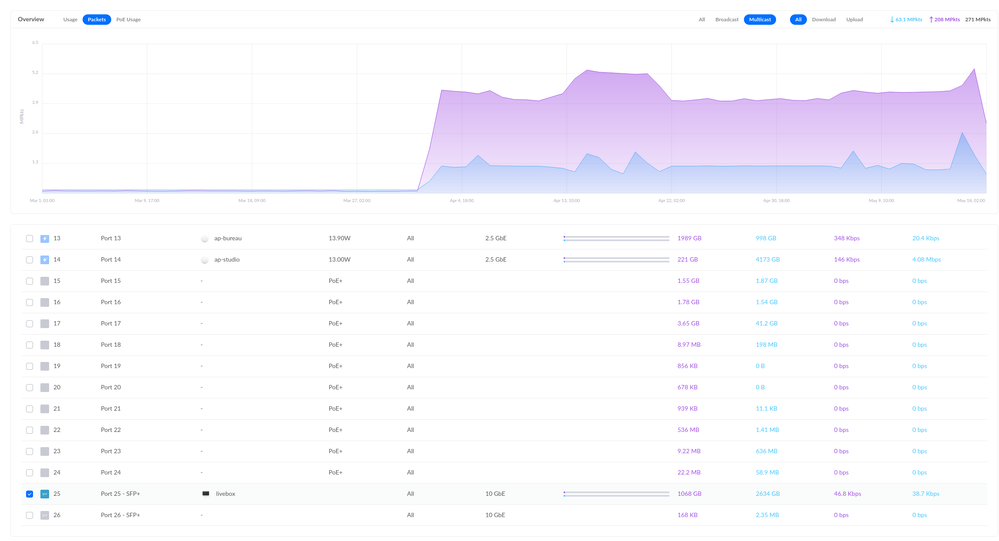

Recently, the TV playback started to randomly freeze, sounding very much like network overload. I tried a lot of things, enabling/disabling IGMP Snooping on the XS12EM or teh MS510TX, but after years without an issue it felt weird. Then I had a look at the metrics reported by the UniFi switch visible below.
One can easily see an increase in multicast trafic reported by this switch. The only thing that happened this day was me upgrading the XS512EM from 1.2.0.0 firmware to 1.2.0.5. Release notes mentions "IGMP snooping is now disabled by default", which sounds a bit weird, for a feature enabled by default since release.
Given the lack of proper documentation as of why this was disabled by default, one can only speculate. For sure enabling did not help, as visible on the chart.
So, could some Netgear people explain a bit more why this was disabled by default ? Is there a known issue ? At the very least, there seems to be something going on, my FTTH CPE has been the same for more than a year, and the TV decoder was around for even more time. We suspected the decoder was dying and it was the cause of the playback issues, but after a few weeks with the new one, it is obvious that it was not the one at fault.
Then checking this chart, one can see the difference on april 2: this is the day I upgraded the switch from 1.2.0.0 to 1.2.0.5.
This release mentions that IGMP Snooping has been disabled by default, which sounds a bit fishy for a feature always enabled by default for most of the switches I know about. Could it be indicative of a known bug? For sure, in my case, enabling IGMP Snooping (and rebooting the switch) did not fix the issue.
multicast change over april 2

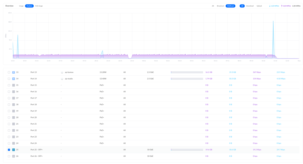

  • So, while I would have loved too get a proper statement from some representative of Netgear on that issue, as of the 1.2.0.7 firmware, I have not been able to notice any of the symptoms I used to suffer from on 1.2.0.5, without any configuration change anywhere on my network.
    Looking a the multicast packets reported by my UniFi switch, there no change while the screenshot above was clearly showing a difference.

  • After much debugging, and checking how to reproduce the issue (changing channel was reproducing very easily this morning), I decided to take my chance and downgrade to 1.2.0.0. For now, this has been running smooth, I cannot anymore reproduce the issue, and better, the Unifi switch does not report so much multicast traffic anymore. I did the downgrade at around 11:10 ; the big spike matching the instant where I reproduced the playback issue.
