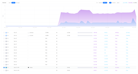

Hello, I've been using a XS512EM switch for years (since 2019-07) as my core switch at home, running flawlessly. It has an Orange Livebox (5 then 6) connected for upstream FTTH, and links to a MS...

Looking a the multicast packets reported by my UniFi switch, there no change while the screenshot above was clearly showing a difference.

After much debugging, and checking how to reproduce the issue (changing channel was reproducing very easily this morning), I decided to take my chance and downgrade to 1.2.0.0. For now, this has been running smooth, I cannot anymore reproduce the issue, and better, the Unifi switch does not report so much multicast traffic anymore. I did the downgrade at around 11:10 ; the big spike matching the instant where I reproduced the playback issue.
