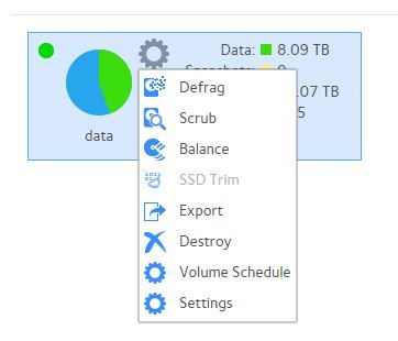

Second: i forgot how to access disktests and will my data be altered or destroyed if i run them?
Click on the settings wheel for the volume (on the volume tab). The tests aren't destructive (unless of course disks fail when they are run).
There are several maintenance functions in there (defrag, balance, scrub, disk test). You might consider setting up a regular schedule to run them. I run each of them once every 3 months.

- StephenBJan 29, 2018Guru - Experienced User
wrote:Can i remove those chunk files since they are old dates?
Yes.
- viperhansaJan 30, 2018Virtuoso
Only have this to choose from...
Edit: found it, i have to make an scheduled event for disktest..
Deleting my chunk files got me back to comfortable 45% usage on system root again.
