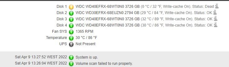

I pull out Disc no 1 and:
Why Disk 1 is Dead if is pull out completely???

- BaGRoSApr 09, 2022Aspirant
Disk 1 is removed and lying on the table!
