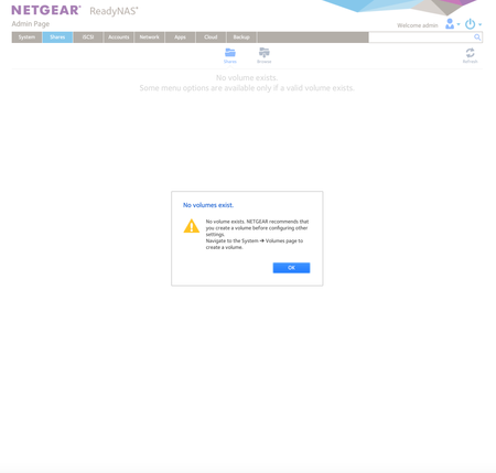

Hi,
Suddenly, I could't access my data on RN214,
I found the following error message on its web page:
"Volume is inactive or dead"
With knwoing, that it's working on RAID 5 system. now all m...
