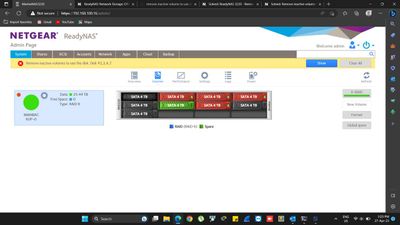

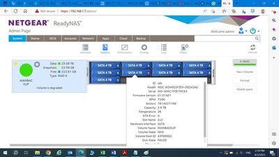

      Kindly find below the Screen-shot before we started the repairing process , from the below screen shot, you can know the Raid level, No of drives, Type & model of the drives, Data Size & Status.
      Screen Shot, before Replacing the drive , OR doing any changes…
      Please find below the current status , and the steps which we have done.
      2) we have added a new drive in the 10th-bay , planning that , once we add the new drive , we will have more storage/ container size , then we will replace the faulty drive in the 6th-bay….
          ( As it is RAID-6 we the Storage-size of 7-drives, and 2 (two)-drives are as failover……) (Total No. of drives installed: 9. ,   so the total space we have is Approx. 26TB.)
      3) but , we have noticed, that this drive is NOT building , and its status remain as :UNKNOWN……
      4) so, later we have removed this new drive from the 10th bay & replaced it with the faulty drive in the 6th-bay…..
      I also formatted the new 6th bat drive , by using the right FORMAT-Tab,
      4) it has formatted , and automatically restarted, and the below status of the drives has occurred , as shown below  .
      5) NOW , I ma sure, that some how the original size of the container (i.e. the 25.44TB  is there , but the parity of the Data is somehow manipulated/ changed.
      6) maybe , I need to reactivate the HD (1, 5, 8, & 9)…….which turned black….
      Finally, do please advice us with your kind feedback.
      Thanking you for your kind cooperation.
      Regards,
      Sohaib M. Naseem Shakir.

        Just to clarify, you appear to have 7x4 TB RAID-6, so volume size is 28 TB (about 25 TiB). RAID-6 has dual-redundancy.  You don't appear to have any disks as as global spares.
        Was the original array using 4 TB drives?  Or was it vertically expanded at some point.
