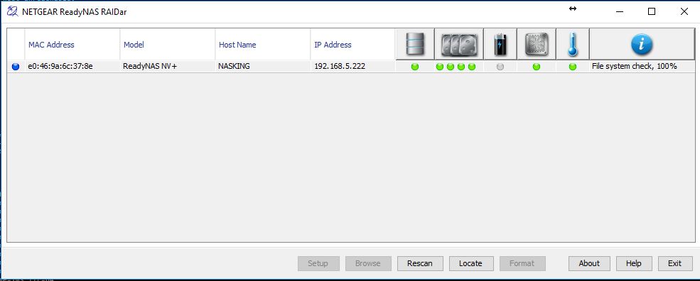

- The RAIDar sees the NV+ and gives green lights on all disks, fans and temp. Disk models, usage and temperatures are displayed.

One more thing I noticed now when looking at the disks in RADIar. RAIDar displays a blue dot at the beginning of the line for my NAS (it's blinking in the help-file, but solid in my RAIDar). From the RAIDar help file this is:
RAIDar Help
*blue dot* Background task active A lengthy background task such as a system update is in progress. - StephenBGuru - Experienced User
