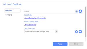

Hi Struggling to get Onedrive backup set up (upload only). RN422 with 6.10.3. Set it up a couple of times (as pictured below) Repeatedly fails. Log shows: Dec 02 21:29:29 Backup ng-c...

It does. On unlimited it works - but the internet grinds to a halt. It seems to go completely full pelt without saving a small % of bandwidth - which makes it pretty unusable except overnight.
Once I put a limit (I've tried 50KB/s and 150KB/s - my broadband upload is about 2Mb/s - so limiting to about half) in it seems to hang after an hour or two and the little 'light' turns from green to blue.
Bug in the throttling code??

- powellandy1Dec 19, 2020Virtuoso
Just to close this off. B_L kindly reviewed logs, found a bug, patched NAS remotely and all working fine.
