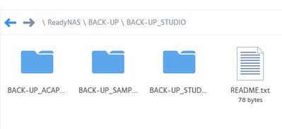

The problem support was referring to is clearly on the BACK-UP volume.
You have a BACK-UP_STUDIO_PROJECTS share but you moved that subvolume under BACK-UP_STUDIO. Similarly for BACK-UP_ACAPELLAS and BACK-UP_SAMPLES. That's where you went wrong.
The snapshots subvolume isn't the issue.
You could do e.g. (note don't copy the #, that's just to prevent blind copy and paste, always think about the commands you're entering):
# mv /BACK-UP/BACK-UP_STUDIO/BACK-UP_STUDIO_PROJECTS /BACK-UP/BACK-UP_STUDIO_PROJECTS

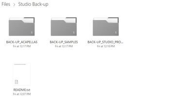

Some additional information regarding my issue: I have placed a txt file inside of the back-up folder and for some reason this txt file is syncing with OneDrive perfectly.
Local storageOneDrive storage
All the other files in the folder do not although the maximum file size is well below the 10GB limit of OneDrive. One folder contains a number of 100MB zip files and these are not synced over... Weird...
I hope you can find something from the logs because it's quite worrying that the Cloud back-ups don't function.
