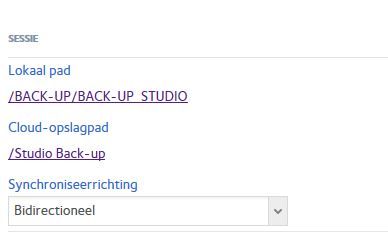

 Hi Guys,
 I have a ReadyNAS 102 running firmware 6.9.3 connected to a EDA500 Expansion Chassis and I setup OneDrive sync for my Cloud back-ups.
 As far as I can tell, I setup everything correct...

After that, I did the same with my BACK-UP volume which is on my EDA500. And on there is the data that needs to be synced with OneDrive:
btrfs subvolume list /BACK-UP
And that resulted in the following:
ID 257 gen 10157 top level 5 path .purge ID 258 gen 10157 top level 5 path ._share ID 259 gen 10160 top level 5 path .vault ID 260 gen 10160 top level 2399 path BACK-UP_STUDIO/BACK-UP_STUDIO_PROJECTS ID 261 gen 10160 top level 260 path BACK-UP_STUDIO/BACK-UP_STUDIO_PROJECTS/.snapshots ID 262 gen 10157 top level 2399 path BACK-UP_STUDIO/BACK-UP_ACAPELLAS ID 263 gen 10160 top level 262 path BACK-UP_STUDIO/BACK-UP_ACAPELLAS/.snapshots ID 264 gen 10157 top level 2399 path BACK-UP_STUDIO/BACK-UP_SAMPLES ID 265 gen 10160 top level 264 path BACK-UP_STUDIO/BACK-UP_SAMPLES/.snapshots ID 268 gen 10157 top level 5 path BACK-UP_APPS_SETTINGS ID 269 gen 10157 top level 268 path BACK-UP_APPS_SETTINGS/.snapshots ID 270 gen 10159 top level 5 path BACK-UP_APPLICATIONS ID 271 gen 10159 top level 270 path BACK-UP_APPLICATIONS/.snapshots ID 277 gen 10157 top level 5 path BACK-UP_OUTLOOK ID 278 gen 10157 top level 277 path BACK-UP_OUTLOOK/.snapshots ID 280 gen 10157 top level 5 path BACK-UP_ARTISTEER_PROJECTS ID 281 gen 10157 top level 280 path BACK-UP_ARTISTEER_PROJECTS/.snapshots ID 811 gen 10157 top level 5 path BACK-UP_LOCAL_ONEDRIVE ID 812 gen 10157 top level 811 path BACK-UP_LOCAL_ONEDRIVE/.snapshots ID 839 gen 10157 top level 5 path BACK-UP_READYNAS ID 840 gen 10157 top level 839 path BACK-UP_READYNAS/.snapshots ID 2399 gen 10160 top level 5 path BACK-UP_STUDIO ID 2400 gen 10157 top level 2399 path BACK-UP_STUDIO/.snapshots

- lobbie1978Sep 04, 2018Tutor
Thanks so much for clearing that up.
Reading your comment, I decided to recreate the BACKUP share and reset the OneDrive sync after that.
As soon as I re-enabled the OneDrive sync, I saw a back-up sub-folder appear in OneDrive. So, I think this might be working now. I'll test a little further to see if all back-up files are uploaded.
I will report back soon.
