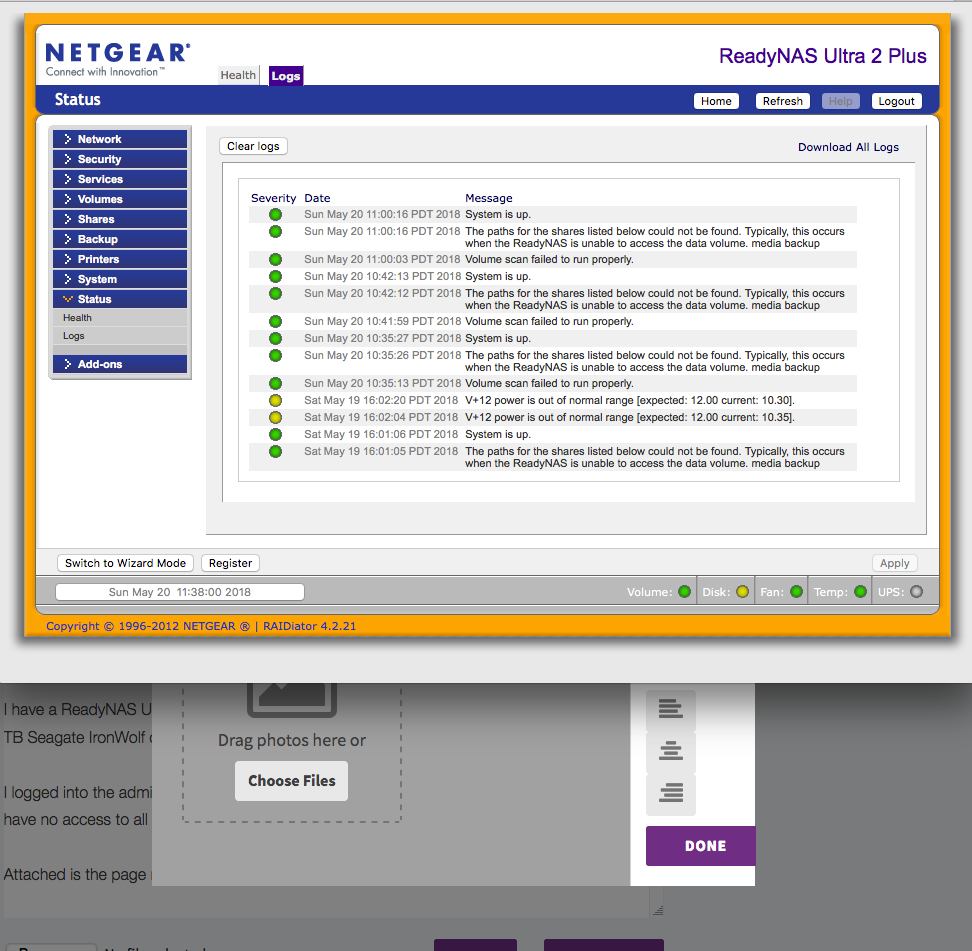

PLEASE HELP. I hot swapped a new drive into the ReadyNAS. New drive fails to scan or run.
I have a ReadyNAS Ultra 2 Plus with two drives in RAID configuration.  I hot swapped a new 2 TB Seagate IronWolf drive into the ReadyNAS chassis.  It was to replace a failed drive.
I logged into the admin page online.  ReadyNAS will not mount.  The drive won't update.  I have no access to all the data that is on the drives. PLEASE HELP
Attached is the page results

      I don't know what condition the failed drive is in.

      I suspect that the housing itself is not functioning correctly.  It was giving the "incorrect voltage supplied" error previously as you can see in the diagnostic image.
      How can I recover the data from the Seagate 2TB drive that had worked originally?

        To be clear, you don't have a ReadyNAS Duo - if you purchased a used Duo, it would not be compatible with your disks.
        A used Ultra, Ultra Plus or Pro would be compatible (including 4 or 6 bay models), but anything you purchase will be at least 5 years old.
        Perhaps a risk-buy of a third-party power brick is worth a try.
        You could of course also replace it with a new ReadyNAS (RN212 or RN422).  You'd set up the new NAS using your new disk (the new NAS will reformat it), and then copy your data from your old NAS using rsync backup jobs for each share.  Then you can move the disk from your old NAS to the new one (reformatting it, and syncing it).
