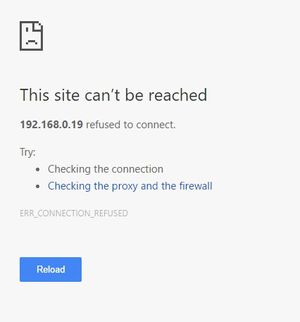

Hi, I've similar problems. I can't access the frontview of my ReadyNas Duo any more. Didn't have problems for years. About 1 week ago I was not able to access the data any more. I rebooted severa...

It seems that disk 1 failed, but the parity disk is fine.
The Duo is running 4.1.6 (the last Sparc firmware that doesn't support using disks that don't support using TLER).
The replacement disk is a WD Blue (I would have suggested getting e.g. WD RED).
I think there's a fair chance that drive bay 1 may be faulty but we'd know more after you've completed your backup and tried a factory reset. I'm not sure whether the ATA errors on the new disk are due to it not supporting TLER or whether they would suggest a problem with the drive bay.
The ATA error count of over 4000 for the old disk was huge so I'd suspect the drive bay may have failed. Not being able to look at the logs does mean that I'm guessing.
This is a fairly difficult situation to troubleshoot on our vintage systems on the Sparc platform. We don't have this issue with any of our models that we've announced since we announced the Duo way back in 2008.
Considering the system's age it may be about time you got a new ReadyNAS e.g. a RN212.
