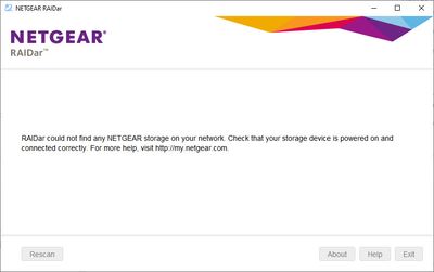

When I run the Raidar tools, I get a message that it can not connect. See image below.
However, I can see in my router that the IP is active and I can ping the NAS and it responds.

- StephenBDec 04, 2020Guru - Experienced User
You might want to power it down, and then reboot it in read-only mode.
Info on doing that starts on page 65 here: https://www.downloads.netgear.com/files/GDC/READYNAS-100/ReadyNAS_%20OS6_Desktop_HM_EN.pdf
