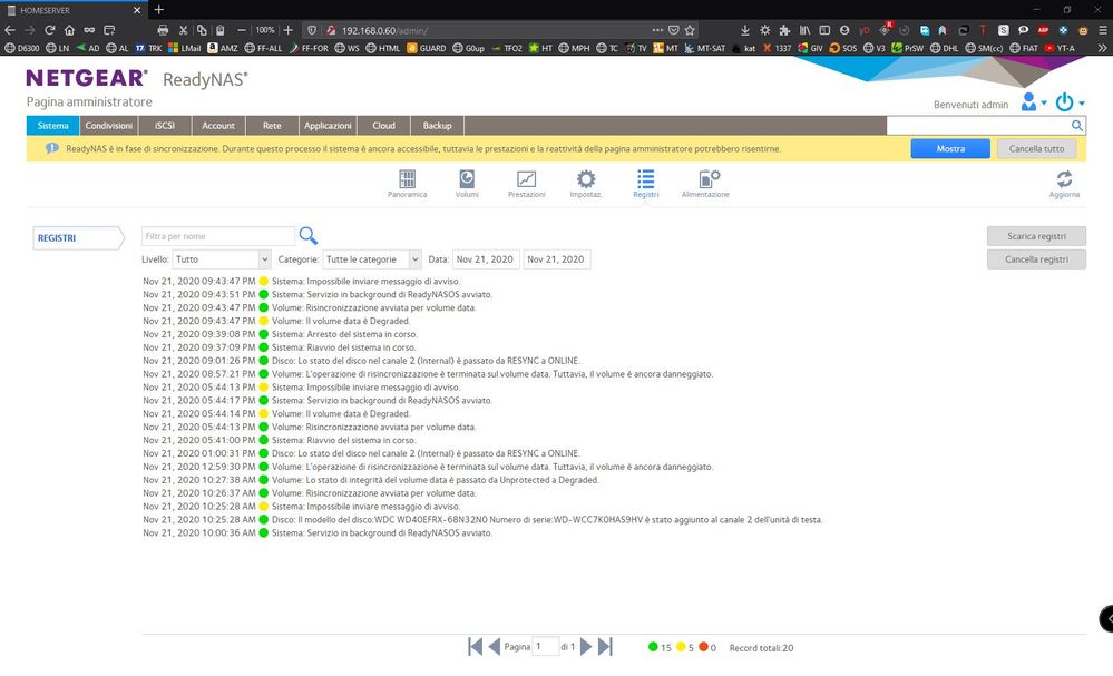

After added the second HDD (just two days ago) something worrying has happened: a few seconds after started the synchronization, on the top of the control panel appeared a bar displayng some error alerts, as for example "impossibile inviare il messaggio di avviso" and "lo stato di integrità del volume data è passato da Unprotecded a Degraded", as you can see here below, in the ReadyNas Registry:
ReadyNas 10200 - 21.11.2020 - Registro errori elaborati dal Nas subito dopo l'aggiunta del secondo HDD (slot 2)
I thought that the error alerts was simply caused by the uncompleted synchronization, so I kept waiting for the synchronization to finish.

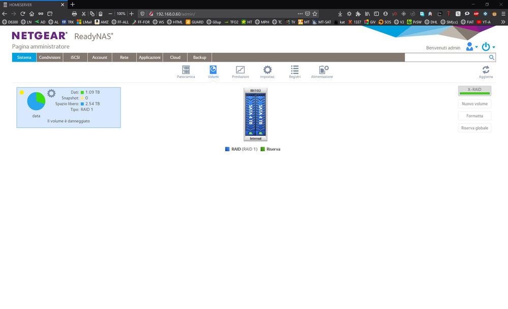

After about 11 hours, the synchronization ended. Both the HDDs was showed "ONLINE" and both with the green led on the ReadyNas Control Panel, but in the little window on the left of the screen was showed the message "il volume è danneggiato" (see the picture below).
If before adding the second HDD, with a single disk (in the slot 1) the volume was "HEALTHY", why immediately after adding the second disk (in the slot 2), the volume was identified as degraded or damaged?

However, as I said, at the end of the synchronization both the disks was showed online and wit the green led on the screen, so I tryied to rebot the Nas, hoping that the error could disappear, but instead the little window on the left of the ReadyNas Control Panel still show the message "Il volume è danneggiato".

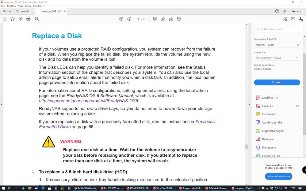

In the event that one of the two disks really needs to be replaced, should the replacement be done with the device off or with the device on and after completed the synchronization (anytime I turn on the device the Nas run the synchronization of the disks)?
.....and the replacement of the disk must be done according to the same procedure regardless of whether the disk to be replaced is the one in slot 1 or the one in slot 2?
RN102 manual

I don't know why you opened a new topic for what you already started in another. The progression you saw, as was explained in the other thread, is perfectly normal, at least up until the completion of the sync. The wording of the messages may make it sound otherwise, but it's not an indication of anything amiss.
You went from a healthy, intentionally non-redundant volume to a degraded (not redundant) volume that is intended to be redundant. The NAS simply changed the definition of exactly the same redundancy state based on the desired final condition and then started the sync process to establish the redundancy.
The only issue here is that the RAID sync did not complete properly. It has absolutely nothing to do with the process you followed or the messages you saw along the way, which were all quite normal. One possibility is that the new drive is faulty. The old one may have developed a problem duing the sync, but I think you'd see much worse symptoms (a dead volume) if that were the case.
Powering down the NAS and testing each drive using a PC and vendor tools is a good next step. I actually always do that before I ever add a drive to an array. There may also be clues in the downloadable log .zip file.
