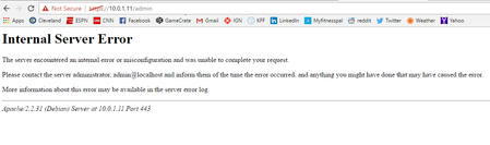

ReadyNas 104 500 error
Hey Folks! So i forgot my password to get into the readynas (password did not work). I did a os reinstall to reset the password back to default. now when I log in and it asks for the password it ...

Your problem is that you have a full OS partition - that is clear from one of your screen shots.

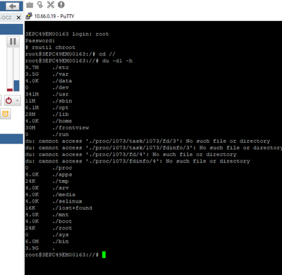

- fayazkhanJun 03, 2024Aspirant
Hi ,
please see attached screen shot of folders and advise on furthur action please
- StephenBJun 03, 2024Guru - Experienced User
fayazkhan wrote:please see attached screen shot of folders and advise on furthur action please
As you can see, the problem is clearly in /var.
