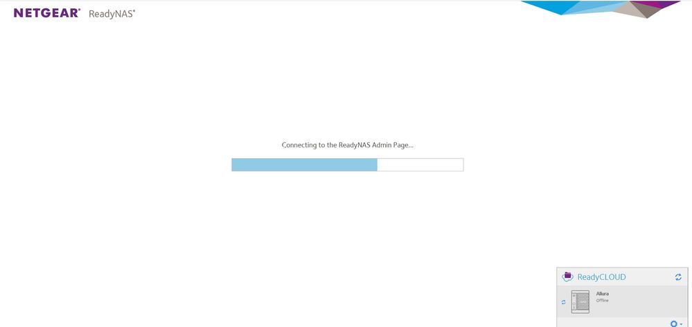

Went to check this morning and the NAS is running, however when I tyr to log in directly to it I'm met with the screen shown in the Jpg and the Desktop client says that it is offline.

This morning for instance I was met with the following screen when trying to login locally to the NAS and via ReadyCloud; however the locally mapped drives were still accessible.
Once I rebooted the NAS everything has worked fine.
