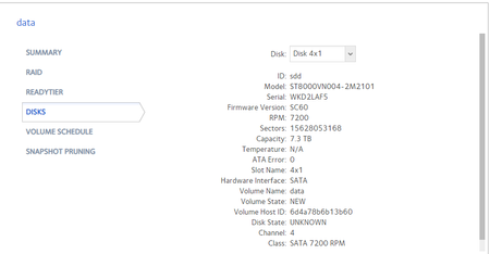

ReadyNAS 214 Volume degraded Replacement disk showing state UNKNOWN
Disk 4 failed. Replaced and started to resynch. Then stopped and said volume degraded. Attempted formatting drive, powering off and on NAS. Somtimes it would re-start a synch and then stop again. Som...

Interestingly I have never been able to do a disk test on the volume. I just get 'Failed to initiate disk test. Disk command failed. Code: 14007010001'
- Froglet0Sep 16, 2021Aspirant
Disk test will not run: I just get 'Failed to initiate disk test. Disk command failed. Code: 14007010001'
