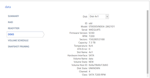

ReadyNAS 214 Volume degraded Replacement disk showing state UNKNOWN
Disk 4 failed. Replaced and started to resynch. Then stopped and said volume degraded. Attempted formatting drive, powering off and on NAS. Somtimes it would re-start a synch and then stop again. Som...

Sandshark Thanks. Unfortunately I don't have a spare drive of that size, however, since I have just left if alone I have had no disk errors. Only had them whilst it was trying to resynch.
Interestingly I have never been able to do a disk test on the volume. I just get 'Failed to initiate disk test. Disk command failed. Code: 14007010001'
- Froglet0Sep 16, 2021Aspirant
Disk test will not run: I just get 'Failed to initiate disk test. Disk command failed. Code: 14007010001'

What firmware are you running?

4190208 blocks super 1.2 [4/3] [UUU_]This says that despite the normal-looking status for disk 4 on the volume tab, the NAS believes the disk has failed.
While this could be bay 4 that has failed, it is more likely to be the disk. One thing you could try is
- power down the NAS,
- remove disk 4
- shift disks 1-3 to slots 2-4 (leaving slot 1 empty).
- reboot the NAS
If bay 4 has failed, then then you won't have any access to your data volume. If disk 4 has failed, then you will.
After the test, I'd power down again and put disks 1-3 in their original position.
If you can test disk 4 with Seatools in a Windows PC, that would likely confirm the diagnosis. I'd run both the long generic test and (if it passes) the full erase disk test. This will take a while (1-2 days) if they both pass, but I suspect they won't.
Either way, if the first test shows it is the disk, then (assuming the refurbished disk is still under warranty), I'd contact Seagate and tell them to send you another one.
FWIW, I'd also invest in some USB drives and put a backup plan in place for the NAS.

OK, so after a lot of hassle with Seagate support I have eventually got a replacement disk back. Unfortunately I had to pay for the duff drive they sent me to be returned to them. I guess the lesson is don't use Seagate drives in future.
Anyway, plugged the drive in (I got them to send me a new drive rather than a refurbished one). Immediately started to synch. Has now completed synch and all is well again.
