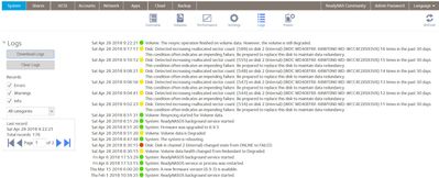

I have just noticed the status on my readyNAS is showing yellow (degraded), from what I can see it looks like one of my drives is failing (purchased 2 x 4TB drives Sept 2015, so approx 2.5 yrs old). Do I definitely need to replace one of the drives? If so, can I replace the failing drive with a larger one realising that there will be a miss-match in size?
Log SnipVolumes Error SnipThanks Rob

    In my view, ~600 reallocated sectors means the disk needs to be replaced.  Generally I won't use a disk if it has more than 50 reallocated+pending sectors; and I start watching it closely as soon as I see any reallocated sectors.
    So you should replace disk 2.  You can use a larger disk, there there will be no storage increase until you upgrade the other one.  The capacity rule for XRAID single redundancy is "sum the disks and subtract the largest".
    Also, you should back up your data - it is more vulnerable when the volume is degraded (and if the first disk fails during the resync you will lose all your data).
    I'm not sure why your volume is still shown as degraded though - can you download your system log zip file, and post mdstat.log?  You can't attach it as a file, but you can cut/paste the text.

      I left the NAS unplugged overnight and restarted it the morning, attached is the mdstat.log file.

        mdstat.log shows one active/working device at the moment (degraded volume, no failed devices and no spares).  That's consistent with removing the failed drive and restarting.
        It'd be good to make a backup.
