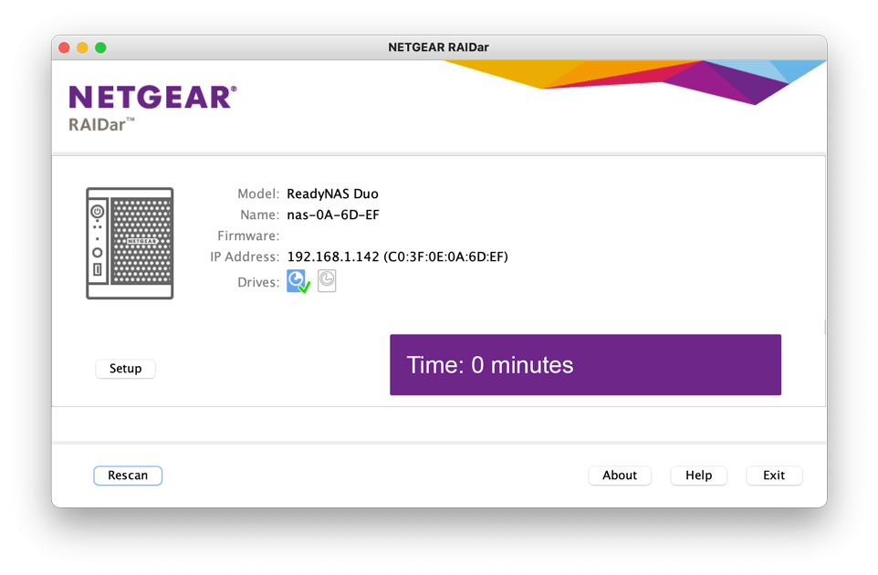

      I did as you suggested, in way of pulling the power plug, removing both disks, then powering up. The Duo's LED flash sequence displayed error code 2, and RAIDar reported the same.
      Upon powering down, then inserting a disk only in Channel 1, then powering up, the Duo displayed error code 3 as you foretold. I then performed a Factory Reset. For anyone interested, this is how long the Factor Reset process takes:
       Then, as you also predicted, I received the Cipher Mismatch error when attempting to access frontview.  However, installing Firefox 94.0.2 was the workaround. I'll look at your other suggested workarounds for that later, thank you.  For anyone interested - I suggest disconnecting from the Internet after downloading Firefox 94.0.2, then open it and click Firefox > Preferences, scroll to Firefox Updates, and select "Check for updates but let you choose to install them".
      My final issue now is the second drive. I hot-inserted it as you suggested. I heard it spin up, I saw some LED activity on Disk 2, and then Frontview alerted:
      Disk add event occurred on SATA channel 2.
      Then three seconds later:
      The disk attached to channel 2 could not be used. The most common reasons are RAID resync in progress, faulty drives, and disks that are too small to be added to the array.
      After this alert, I have waited an hour, just to see if a RAID resync is happening, or if some other alert might indicate anything, but I see no change to any status. RAIDar reports the drive in Channel 1, running at a nice, low temperature, and Channel 2's drive as "Not present".
      What would you suggest I try to get this second drive working?  This is the replacement drive, which I used to copy all the data to, so I know that it is in fine working order (I copied the data elsewhere, so it's fine for this drive to now be formatted by the Duo now).
      • JaydenL's avatar
        JaydenL
        I tried reformatting this second drive (will called it Disk 2) to exFat, but received the same response from Frontview when doing a hot-insert.  So I powered down the Duo, took out both disks, inserted Disk 2 in to Channel 1, booted the Duo, then RAIDar reported a sequence similar to a Factory Reset in the gif in the previous post.
        The Duo completed the "creating volume process", and started up successfully with Disk 2 in Channel 1, so it appears that the disk was not the problem. I have just now hot-inserted Disk 1 (in the previous post, this is the working disk that was in Channel 1), in to Channel 2. I hear it spin up, but then nothing. No alerts in Frontview, and RAIDar reports the second drive as "Not present".
        Any ideas what to do here?  Perhaps there's a Duo hardware issue with Channel 2?
