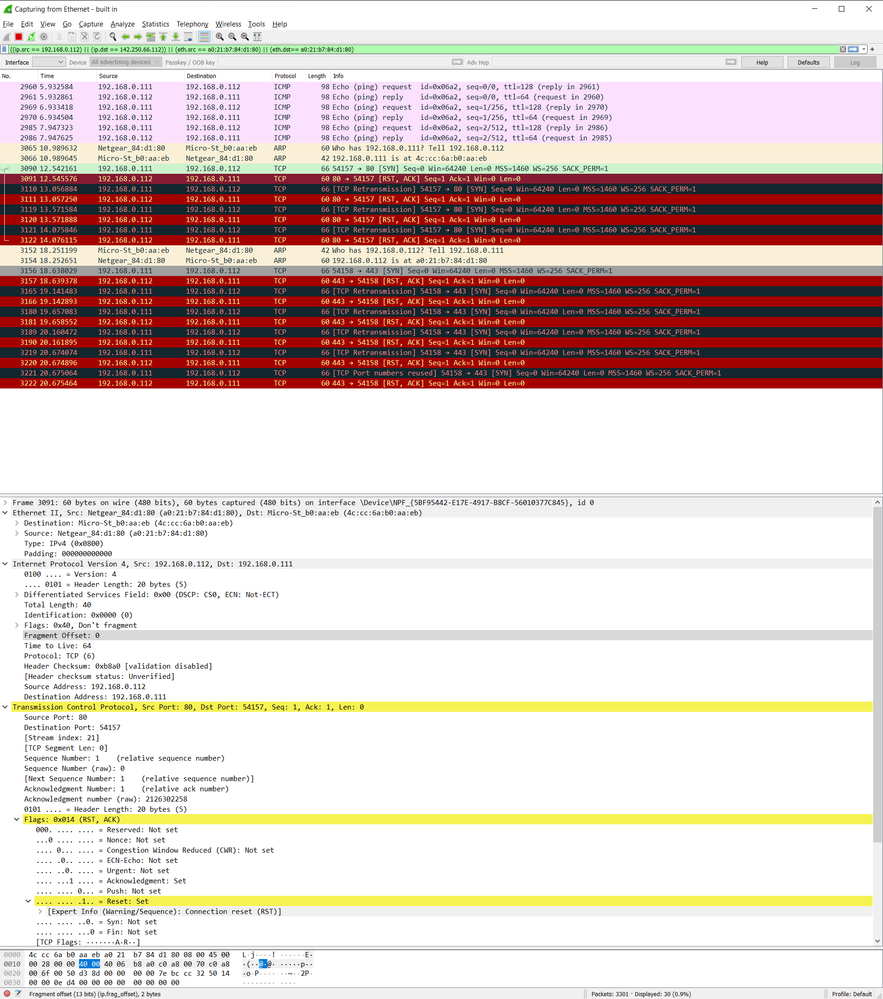

My (ancient) ReadyNAS Duo RND2000v2 have been working flawless for years, but all of a sudden it stopped working:
It's no longer possible to access, neither from Windows. It doesn't even open the web interface.
Strangely responds to PING, so its obviously not entirely broken.
Yes, I've double-checked that the CIFSv1 support is still enabled in my Windows 10 Home 21H1 build19043.2006 Experience Pack 120.2212.4180.0, rebooted my computer, rebooted the NAS etc. I know the firmware installed in the NAS was the last one released by Neatgear before the model was discontinued.
I've caught some Wireshark traces (attached), showing the NAS seemingly rejecting connection attempts on HTTP, HTTPS and file share ports.
Any ideas?
Can I factory reset it somehow without loosing the content of the discs? Or can I transfer the discs to a new(er) NAS? Is it even possible to buy a Netgear NAS anymore? Readout the content of the discs on a Linux box?
    Let's start with that.  A few months ago the browsers began requiring TLS 1.2.  The legacy NAS (Both Duo and Duo v2) only support TLS 1.0.  Access the web browser with current Chrome, Firefox, or Edge will give you an SSL or Protocol Mismatch error when you try to access the web interface.  Is that what you are seeing?
    Also, have you tried using RAIDar?  It'd be helpful to know what status it is giving.
    Also, let us know if you are running 4.1.x firmware or 5.3.x firmware.

      Oddly enough, this is the third time I try to respond to your follow-up question. The first two attempts vanished into the cyberspace somewhere.
      Radidar doesn't respond any firmware version at all, just that both disks are checked green.
      The UDP response from the NAS to raidar's information request is
      a0:21:b7:84:d1:80 NAS 192.168.0.112 fan!!1!!status=ok::descr=1630RPM
      ups!!1!!status=not_present::descr=Not present
      volume!!1!!status=ok::descr=Volume C: RAID Level X, Redundant; 307 GB (33%) of 921 GB used
      disk!!1!!status=ok::descr=Channel 1: Seagate ST1000DM010-2EP102 931 GB, 0C/32F[Sleeping]
      disk!!2!!status=ok::descr=Channel 2: Seagate ST1000DM010-2EP102 931 GB, 0C/32F[Sleeping]
      model!!0!!mode=home::descr=ReadyNAS Duo::arch=nsp
      Boot!!FS_CHECK!!100%
      BOOT
      66 1 1
      Or as raw data
      C1BC733479FFFFFFFFF00A61303A32313A62373A38343A64313A3830094E4153093139322E3136382E302E3131320966616E21213121217374617475733D6F6B3A3A64657363723D3136333052504D0A75707321213121217374617475733D6E6F745F70726573656E743A3A64657363723D4E6F742070726573656E740A766F6C756D6521213121217374617475733D6F6B3A3A64657363723D566F6C756D6520433A2052414944204C6576656C20582C20526564756E64616E743B20333037204742202833332529206F662039323120474220757365640A6469736B21213121217374617475733D6F6B3A3A64657363723D4368616E6E656C20313A205365616761746520535431303030444D3031302D324550313032203933312047422C2030432F3332465B536C656570696E675D0A6469736B21213221217374617475733D6F6B3A3A64657363723D4368616E6E656C20323A205365616761746520535431303030444D3031302D324550313032203933312047422C2030432F3332465B536C656570696E675D0A6D6F64656C21213021216D6F64653D686F6D653A3A64657363723D52656164794E41532044756F3A3A617263683D6E73700A426F6F74212146535F434845434B2121313030250A09424F4F540A09363609310931
