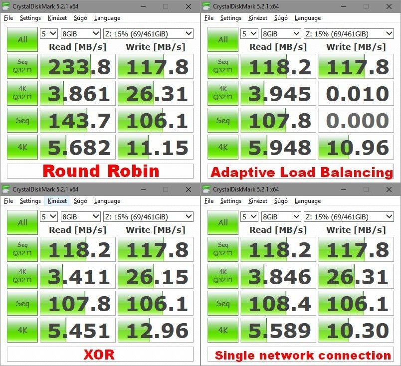

Usually just my PC use the NAS, and the network. My wife use her laptop and mobile phone, but just for internet browsing, not more, I think it is not a heavy load. And I have a Samsung smart TV, this play movies from NAS on DNLA. It can be higher traffic, but it can work on a 802.11n wifi too, I don't think about heavy load.
Round Robin better for me than XOR?
Windows and teaming: The newer Intel driver support it again (it was supported in the past, long time ago in a galaxy far far away), now the driver over 22.x.x support it, I attached pic from it
