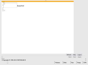

ReadyNAS NV+, FrontView Admin Page is not rendering correctly
Hi all, As you can see above, FrontView is not displaying properly and is unusable. I've tried Safari, Firefox, and Chrome on macOS Big Sur as well as Safari using iOS 14.5 I can acces...

It's been a long time since I ran an NV+, but I did see that kind of display when one of the configuration files was corrupted. An OS re-install fixed it. But if the corruption is a result of an overfull OS partition, then an OS re-install isn't usually a good idea. I donm't know if an overfull OS partition is as common on RAIDiator 4.1.x as OS6 -- I don't recall it coming up here nearly as often, even though the partition is even smaller.

SandsharkThanks for the reply. I don't know my OS partition is overfull, but I did an OS re-install yesterday without success. I'd like to avoid a complete factory reset if possible. Do you have any more ideas?

Frontview is working correctly now. Thanks for helping.
The solution was emptying the netatalk.log log file that filled the 2GB OS partition. The netatalk service is used for AFP and Time Machine.

I have similar symptoms. On Raidar the status is healthy, firmware is 4.1.16, and all 4 drives are checked as ok. When I press the admin page button the response is "Your netgear storage is not accessible from this computer, please check your network setting." And when I try to access admin I get frontpage skeleton similar to yours. Just a few more parts of it.
How did you empty the netatalk.log log file? Perhaps that is the key? Thanks
