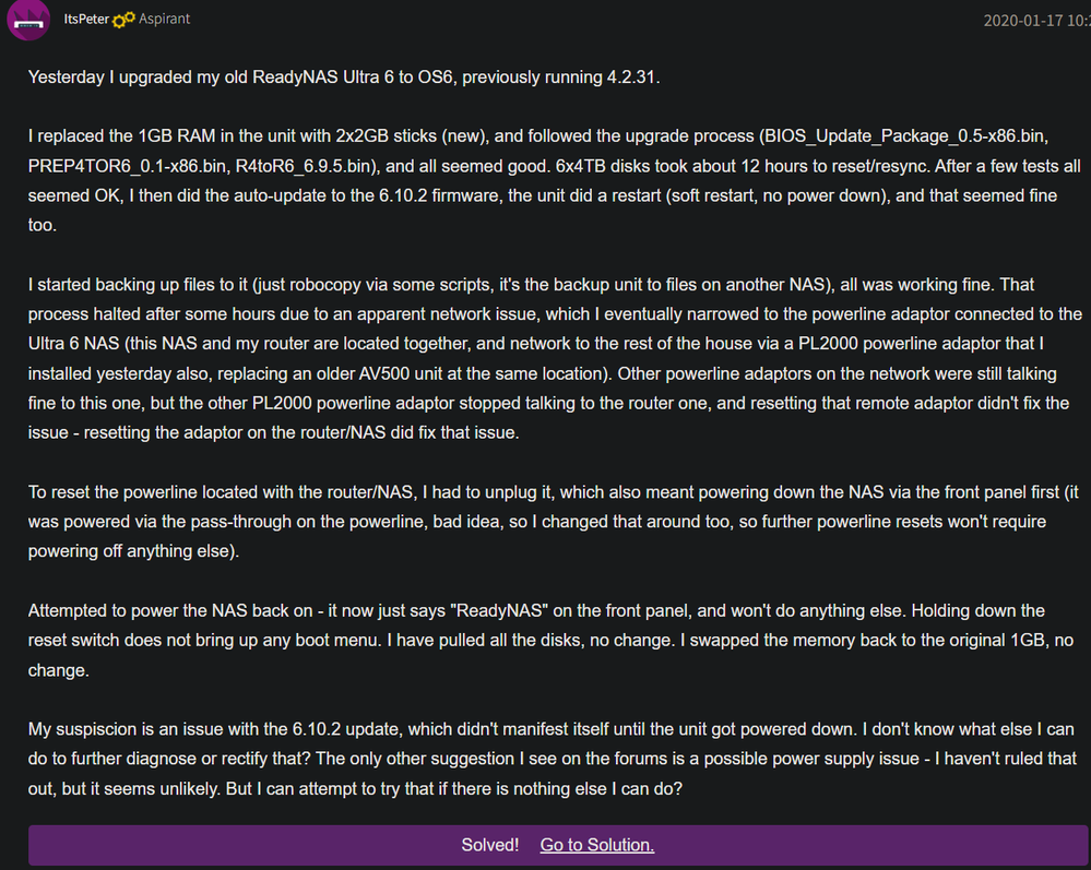

Same problem per the discussion shown on the 2 attached image, on that post the problem was id as "VPD lost or corrupt".

        I saw my name tagged, I assume based on this thread:
        https://community.netgear.com/t5/Using-your-ReadyNAS-in-Business/ReadyNAS-Ultra-6-doesn-t-boot-Stuck-on-quot-ReadyNAS-quot-prompt/m-p/1851115#M184104
        @Shanedu have a read through that if you haven't already, your scenario does sound similar to mine, and I gave a pretty detailed run-down of every step I followed and everything that happened, including various screen shots, so you should be able to tell if yours is stuck the same way.
        Unfortunately this was NOT a self-service fix from this state, and I had to supply the serial number and other info from the unit, and get supplied encrypted files to re-flash what had become corrupted on the unit. Apparently it's something that can just happen doing these upgrades, no real way to detect it or work around it.
        If yours is stuck the same way, I would try contacting mdgm if he's still around, you can see his posts in the thread above, I recall he provided me some additional pointers on some things to check, and how to go about rectifying it all.
