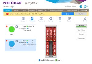

Yesterday our ReadyNAS Pro 6 running firmware version 6.8.1 became inaccessable and upon reboot, shows the main voulume missing: This problem occured without any error warnings before...

If you click in the box for the upper volume, does it then highlight just the drive in bay 5?
I agree that it is best to wait for a Netgear rep to look at your logs. But what it looks like to me is that your NAS somehow thinks that the drive in bay 5 is a separate volume, the main one at that, and is complaing that the remaining drives are "dirty" with data from some other volume, also named data. But two volumes with the same name are not allowed. In that case, booting with just drives 1, 2, 3, 4, & 6 would likely work.
