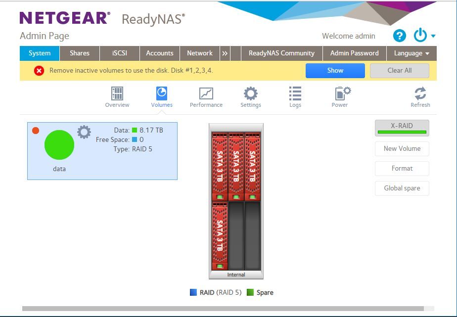

1) I went on vacation from 2018-08-13 until 2018-08-25, upon my return, the (OS: 6.9.3, BIOS: Flame6-MB 2010-07-26) ReadyNAS Pro 6 NAS (protected by a 1500VA UPS) was inaccessible. Upon reboot the following log entry was found to be the last one:
Tue Aug 14 2018 7:00:01   Snapshot: Snapshot c_1534244400 was successfully created for share or LUN shared_files.
so, it appears the NAS was locked up for about 10 days.
2) Then, resync occured
Sun Aug 26 2018 4:15:09   Volume: Volume data is resynced.
Sun Aug 26 2018 0:35:09   Backup: Error backup job A01 to rnduo Media: Source path cannot be accessed.
Sun Aug 26 2018 0:34:58   Backup: Successfully completed backup job A02 to rnduo data except Media.
Sat Aug 25 2018 20:57:26   System: Antivirus scanner definition file was updated to 58.24873.
Sat Aug 25 2018 20:41:29   System: ReadyNASOS background service started.
Sat Aug 25 2018 20:41:06   Volume: Resyncing started for Volume data.
Sat Aug 25 2018 20:38:55   System: The system is rebooting.
Sat Aug 25 2018 20:34:47   System: ReadyNASOS background service started.
Sat Aug 25 2018 20:34:25   Volume: Resyncing started for Volume data.
Sat Aug 25 2018 20:34:21   System: ReadyNASOS service or process was restarted.
3) The resync was successful, but the previous shares are not visible, and it appears the data is gone, the backup schedule is not accessible. Each of the four disks show 0 ATA errors.
4) I downloaded the logs.
5) Did I have a backup? Yes, but it got overwritten. - job A01 was my Media files and job A02 was everything else backed up via rsync to a ReadyNAS Duo. A further problem is that during the resync period (Aug 25/26), job A02 completed (scheduled daily at 00:05), erasing my backup on the ReadyNAS Duo, so those files are gone on the healthy backup device. It would be good in future OS6 releases, if backup jobs were prevented from running during a resync.
Any advice would be appreciated.
