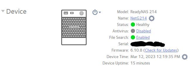

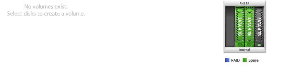

        Not sure how to boot in read-only mode, but it booted up fine and I can access it through the GUI.  This is what it shows:
      The OS seems fine.  It seems to be that it lost the volume pointers.

        You boot in read-only mode via the boot menu.  See How-do-I-access-the-boot-menu-on-my-ReadyNAS-102-202-212-or-312 .  The reason for booting in read-only is to keep the drives from becoming more out of sync before you determine which ones work (if any combination does).  At this point, I'd try the drives in bays 2 and 3 first.
        If you can't get it to boot with a readable volume, it would be best if somebody reviews your log files to see what recovery method may work for you.  You can't (and don't want to) post the log file here.  You'll have to put it on a file sharing site (such as Dropbox or Google Drive) and ask a moderator or perhaps StephenB to review it.  With recent changes in moderators here, I'm not sure who that would be.  And I'm just not the right guy for it.
