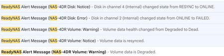

ReadyNAS RN104 Dead Message
I have had no problems with my ReadyNAS RN104 for 7+ years in RAID 5, when a few days ago I got this message: "Disk in channel 4 (Internal) changed state from ONLINE to FAILED." I had been running wi...
