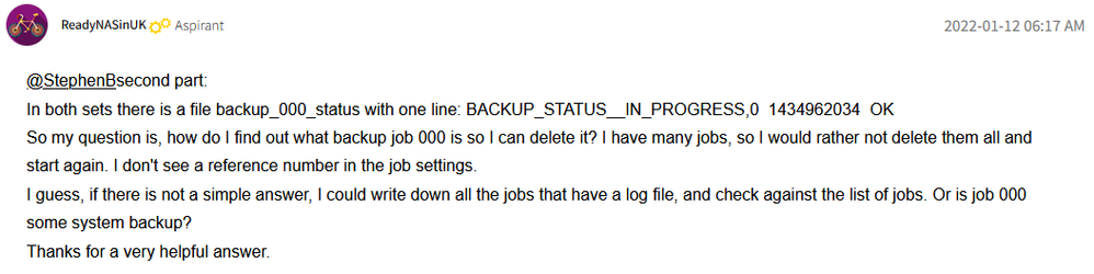

4. In both sets there is a file backup_000_status with one line: BACKUP_STATUS__IN_PROGRESS,0!!1434962034!!OK
So my question is, how do I find out what backup job 000 is so I can delete it? I have many jobs, so I would rather not delete them all and start again. I don't see a reference number in the job settings.
I guess, if there is not a simple answer, I could write down all the jobs that have a log file, and check against the list of jobs. Or is job 000 some system backup?

- ReadyNASinUKJan 12, 2022Aspirant
StephenBfor some reason I can't post part of my message so here it is by screenshot!
