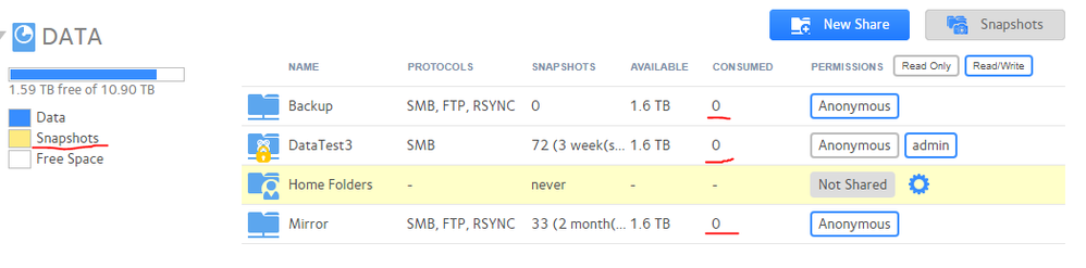

ReadyNAS share consumed space always 0
I'm not seeing the space consumed by share or total space consumed by snapshots.

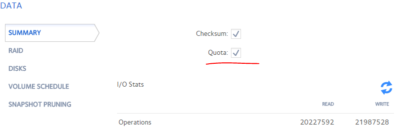

I used to be able to see it, but than i disabled and re-enabled 'Quota'.
Anyway to get it back?

- StephenBGuru - Experienced User
you should see it if quotas are enabled via the volume settings.

NETGEAR Community Team- defcon84Guide
Same issue on different browser.
Flashing and/or upgrading firmware is not possible at the moment. It's a production server.
And it wordt before I disabled and re-enabled 'Quota' on the volume.
