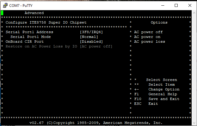

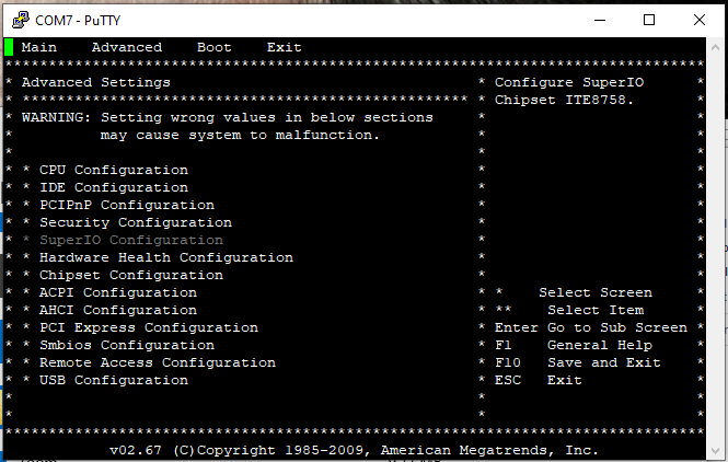

BINGO! Got into the BIOS (Del key for this model), went to Advanced Options, SuperIO Configuration, and set "Restore on AC Power Loss by IO" to "AC power off"... It was set to "AC Power On" as proven by the above troubleshooting.
BIOS Advanced OptionsBIOS SuperIO Configuration

- I plugged a USB keyboard in to one of the back USB ports but probably didn't have to. As soon as I plugged in the NAS, it powered on as expected. A few characters displayed and then I was presented with a normal looking AMI Motherboard BIOS screen telling me to press DEL if I wanted to enter setup. My main computer keyboard was able to control the output as I hit Del there and not on the keybaord I plugged into the NAS. I jumped in the BIOS and that was that...
Now my NAS stays off when the power cord is disconnected and reconnected (or when my UPS cuts power and then restores it for any reason). Definitely not for the faint of heart, but also not impossible either. Hope this helps someone in the future.
