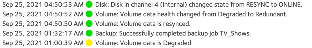

Just a side note - One of the ReadyNAS (RN104 - in another discussion) after replacing HDD in slot 3 just now has popped up slot 4 as degraded and this time it is just a black dot rather thana yellow next to it.
UPdate - apologies it is now yellow and has ATA count of 13 - wow !! It was fine all along - crazy to say the least - currently re-syncing

niallryan wrote:Just a side note - One of the ReadyNAS (RN104 - in another discussion) after replacing HDD in slot 3 just now has popped up slot 4 as degraded and this time it is just a black dot rather thana yellow next to it.
Update - apologies it is now yellow and has ATA count of 13 - wow !! It was fine all along - crazy to say the least - currently re-syncing
Ouch. Maybe run the disk test after the resync completes.
- SandsharkSep 27, 2021Sensei
I agree. A drive that is ejected from an array usually has something wrong with it, even if it's re-added and properly syncs. If you can afford the time, powering down and testing that drive with the appropriate vendor tool (except don't do the write test) is also a good idea if the NAS disk test passes.
