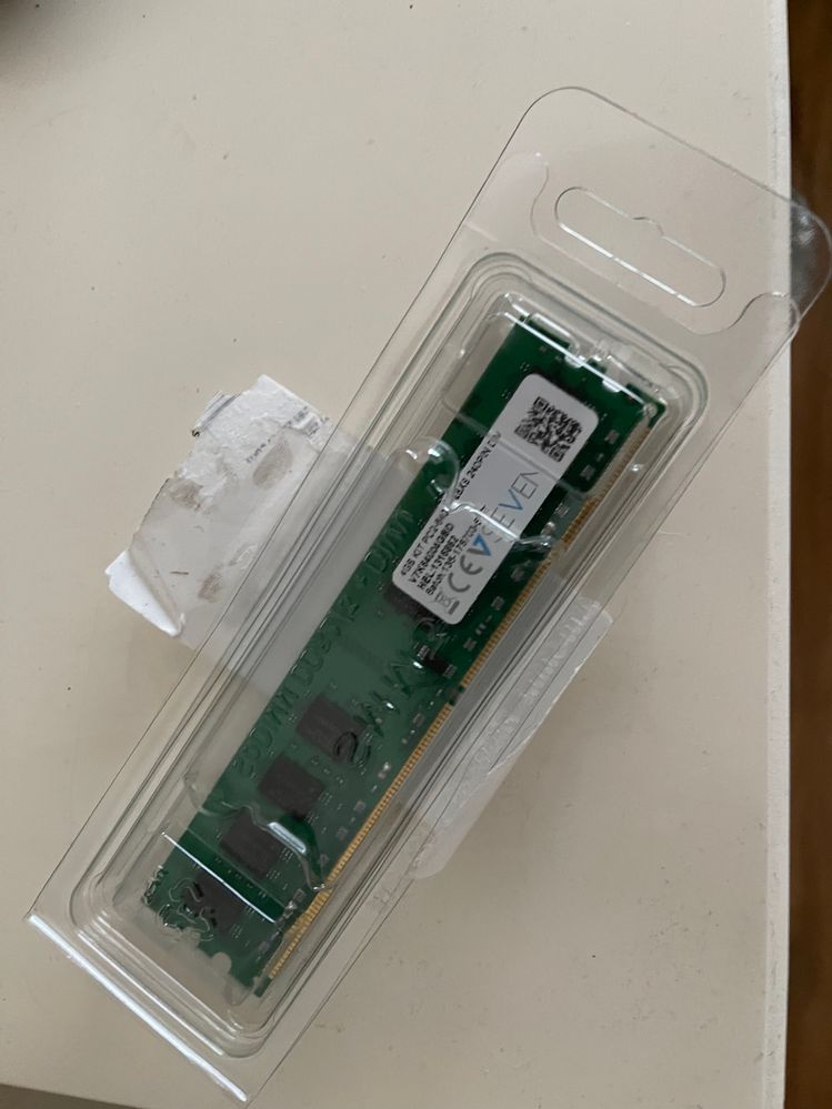

- niallryanOct 29, 2021Guide
Picture attached - the order was for 2 x 2GB sticks as previously posted and they send me this with the sticker on it saying 4GB
Picture was taken when I recevied the packaging as I also purchased a WD Red Plus 4TB HDD - The White sticker was as is when the box was opened so I think I will be going back to the supplier with a complaint as it is obvious they either made a mistake or tried a quick one. Benefit of doubt will be a mistake of course :)
Regards
N
- StephenBOct 29, 2021Guru - Experienced User
The part number is for a kit (e.g, 2x2GB). I am thinking you simply didn't get both the sticks you were supposed to get. I suggest contacting the seller, and asking for the other stick.
Was this used memory, or new?

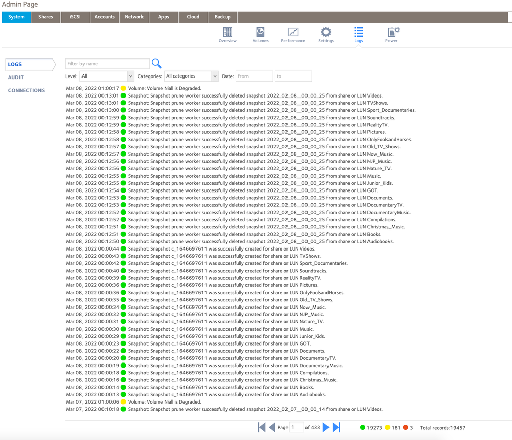

- niallryanMar 08, 2022Guide
Hi guys, just in addition to my previous post (last updated) I have just had the NAS 4 web page reset on me but yet it did not reboot the NAS at all. When the Web page reset it gives the same screen as the NAS rebooting as in the long blue loading bar appears. When it finished it allows me to log in again as normal. This is the first time I have seen this happen (but it may be because the NAS is degraded). When I logged in I went to the logs and there it was.....
I also have noticed that something is triggering at 1 am every day as I see the yellow dot showing Volume: Volume Niall is Degraded.
The new WD RED Plus 4TB should be arriving today.
Just to refresh my memory - do I just replace the dead drive (bay 3) with the replacment drive while the NAS is runing or do I power down and replace and then boot up ?
Also currently am I ok in continuing to add files to the NAS while it is degraded and all will continue as normal ?
Regards
N
- StephenBMar 08, 2022Guru - Experienced User
