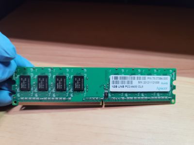

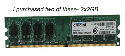

have an Readynas Ullra 6 (RDNU6000) with 6x3TB installed. RAIDiator ver 4.2.31. Flex-RAID level-0. After viewing post from Mook1 "Ultra 6 Memory Upgrade Verification", post 1125490,  I wanted to upgrade the Ram from the original 1GB to 2x2GB, which is the max for this unit I backed up all my media prior to trying this upgrade. I have physical raw Hard Drives backups for all my media. I purchased the same Ram with specs as User "sotrack" had posted photos of the RAM he uploaded. I ran the "Memory Test".  After 5 hrs the display showed results "PSS-2, Error-O". Since I was unable to exit the memory test mode (didn't really know how to), I powered down the unit. After powering it back up, it is still in the Boot menu mode.The display shows "Boot menu". I pressed the back-up button to select "Normal" mode. I then pressed the reset button to reboot in "Normal".mode It reboots and now getting a display message "Error, no disks detected". I don't know what to do from here. Any suggestions would be apprecitated.
